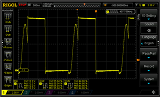

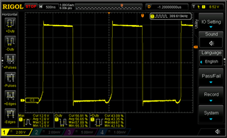

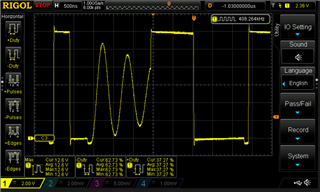

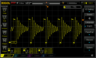

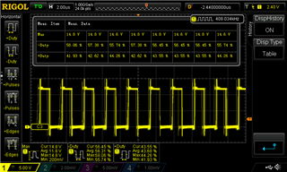

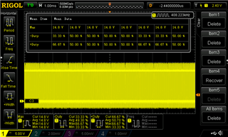

In our project, we are using LMR36506
Vin: 8-36V
Vout : 5V, output current around max 400mA
Schematic is attached.
L2 is SRN6045TA-470M
The RT resistor (R7) is 16.5k, which shall be changed to 39.2k. (The RT resistance is currently 16.5k.)
For the output capacitors C2 and C3 (2x 22u-10V), coil ringing decreases significantly when we place two more on the output side (a total of 4x 22u-10V).
Could you please let us know if there is any mistake related to the schematic?
How can we solve the coil ringing issue?
