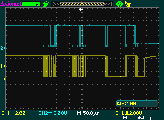

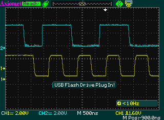

    Here are some captures from my oscilloscope. Note that the timebase is not accurate. There is some bug in my oscilloscope that causes it to
    change timebase when I press the print-button.
    Here we can see that the request to address 0x74 and 0x75 is at a slower speed.
    We can also see that there is some strange behavior of the clock signal after the last transmission, there is a slower rise time above a certain point.
    This is not seen on the other packages. Strange.
    Close up on the strange rise time behavior.
    The signal integrity of the ~800Khz clock looks fine to me.
  • Hi Pontus,
    One quick note regarding the TPS25762-Q1 FW. During boot from EEPROM, the FW starts with using 1MHz I2C clock rate. If the communication fails, it reduce to 400KHz and retries, then 100KHz before it reports EEPROM load failure. So although we've both observed that the 24LC256-I/ST EEPROM works despite the max clock frequency defined as 400kHz in its datasheet, there is a fail-safe mechanism in place.
    Thank you for providing the scope captures. The I2C signal integrity looks fine to me as well. One thing I noticed though is that there is a ground offset. Are there any AC signals around the I2C bus? What is the highest voltage level when the I2C lines are pulled low?
    The rise time you pointed out is indeed strange as the rise time looks considerably long.
    Can you please confirm if the what is highlighted in red in the image below are I2C clock pulses? Can you zoom into this one? It would also help see the signals' voltage levels if you could set the 0V reference on a y-axis partition line.
    Have you tried changing the pull up resistor values to 2.2k? The EEPROM's datasheet also recommends 2k ohm for pull up resistor values.
    Your schematic did not show anything, but are there any other devices on the same I2C bus that are perhaps hidden from the PDF?
    Can you also share your PCB design files or gerbers?
    BR,
    Seong
  • Hi Seong
    Thanks for that note. I was wondering about that. Then that shouldn't be cause of the issue.
    I don't think there is any AC signals on the board.
    I think that the offset was the one I had set so that the channels would be separated. But there seems to be some offset building up on the data line at the end.
    Here is a screenshot with the voltage offset reset to 0 on the scope
    As you can see, the data line does not go down to 0v at the end.
    According to the cursor, there is a ~240mV offset for both lines. But I think it's an issue with the scope.
    My other scope and my multimeter does not show any voltage after the trafic has stopped, but this scope does still show the same 240mV offset.
    Here is a close up-
    Here is a close up that you requested, at the end with the strange rise time.
    It is indeed a clock signal. I cannot get a higher sampled capture as the scope is buggy and wont trigger correctly when I lower the timebase.
    I've not had the had the chance to change the pull-up resistors yet. I will see if I have any 1K or 2K on hand.
