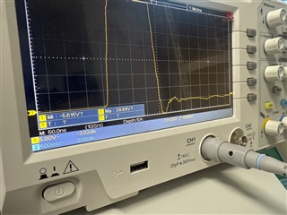

  • Hello Ben, thank you for your reply.
    Below are photos of the oscilloscopes of the PG and SW Nodes you mentioned.
    PG Signal
    SW Node
    Is there any additional information you need?
    thank you.
  • Hi Jun,
    Does the PG pin have a pull-up voltage? The PG pin shows that it is low which means the output voltage is below the operating range.
    If the design is for 400kHz, the SW node plot doesn't appear correct. Are you able to zoom in on the SW node?
    If possible, can you load the output to 2A/24V and recapture the SW and PG signal?
    Ben
    There is currently no load on the PCB board.
    The PG pin is pulled up to the VDDA voltage through a 100K Ohm resistor.
    Below are pictures of each node with a load of 2A.
    PG Signal
    SW Node
    Thank you.
  • Hi Jun,
    The PG signal does not look correct. What is the measured output voltage when the PG signal was measured?
    Ben
  • I think it's roughly 1V.
    Thank you.
  • Hi Jun,
    The PG pin is working correctly. The scope shot was taken while the output load current was set at 2A? The conditions are 48V to 24V with IOUT=2A, correct? Is the current from the power supply set properly?
    Ben
