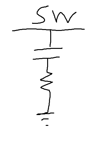

HI Ridge,
Is the snubber circuit placed between SW pin and GND, correct?
Hayashi
Hi Hayashi,
Yes. It would look like this:

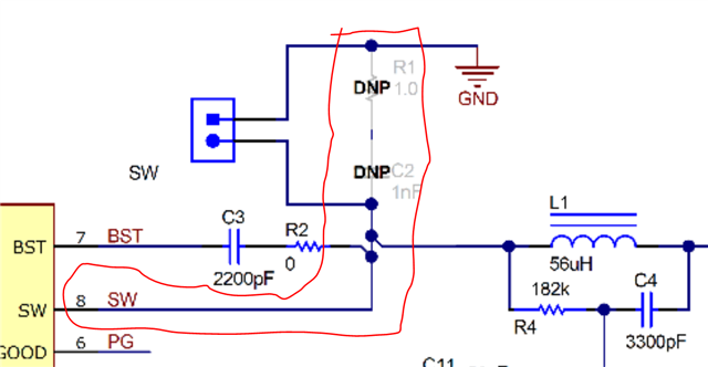

Here is an schematic example on an EVM. It is a little difficult to see since those components are DNP, but it shows the general idea:
