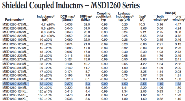

Dear Experts Greetings from Istanbul.
I need advice abouth my An inverting and non-inverting step-down output design.
Due to my limited pcb space and component count I need to get both + and - output from a single step down DC/DC Converter.
Q1- Is this design technicaly correct ?
Q2- If not, i would be grateful for your valued information on how to fix and improve it ?
Q3- I would also be great if you could help me to choose correct components.
Best Regards

    Thank you very much for your quick reply and valuable comments. I made the change you specified. Finally, after your short answers, my problem will be solved.
    Q1- Is 1Mhz design suitable? Or i can able to re-design as 400kHz thanks to LMR33640 settings
    Q2- I do not need to isolate the ground connection in my circuit. Does it cause a problem if I connect it directly to the common ground?
    Q3- According to my output voltages/current consumptions, does the coupled inductor I choose meet my needs?
    Thank you.
    I have listed my answers to correspond with the questions.
    Q1: Either 1MHz or 400kHz is OK
    Q2: Connecting the to the same GND is OK. As you stated, it will not be an isolated output.
    Q3: That inductor is very large for this application. I calculate 8.2uH using Equations 16 and 17 in the application note linked in the above post, assuming Fsw=1MHz. Peak current mode devices require a certain amount of current ripple to regulate properly. Target 20%-40% current ripple.
