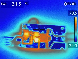

  • After some effort I managed to get it working. I replaced the output inductor with a 10uH and added a 100nF capacitor to the Cboot capacitor. The regulator works normally when idle, but when I start drawing current I hear a noise from the inductor and when the current reaches 3.2A it starts to heat up as seen in the image. I think it needs to be optimized more. Do you have any suggestions for optimizing it more?

    The boot cap should be 100nF, no need for higher as this needs to be charged by the VCC cap without discharging it too much. The quickstart file is incorrect, as Cout is not 188uF. Each 47uF ceramic cap will derate significantly at 5VDC (maybe to ~20uF each - check the cap datasheet for the derating curve with voltage). If I put Cout = 80uF in the quickstart attached, the recommended compensation values are 4.22kΩ, 10nF and 150pF.
    LM5148_LM25148_quickstart_calculator_A4 - 48Vin 5V 10Aout at 440kHz.xlsm

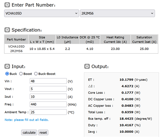

    Based on the attached quickstart, the ripple current is high at 47% with a 2.2uH and this will cause high core loss (check the Wurth loss tool). 10uH then is too high, causing low ripple current and very little ramp for current-mode control. I think 2.8-3.3uH is ideal here if you're using that Wurth series, giving 30-35% ripple current. Alternatively, use the Cyntec VCHA105D 2.2uH with these losses:
    https://www.cyntec.com/CoreLossCalculator.aspx?id=7
