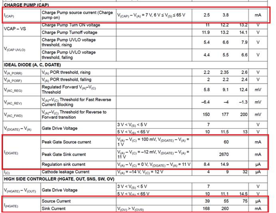

   We are currently evaluate LM74810-Q1 controller current consumption ( quiescent current of this controller in normal operating mode)
(1)I saw the controller define total system quiescent current = 396uA @ Vin=12V.   May I know we can just use the quiescent current for the controller total current consumption evaluation?
(2) One more questions , May I know what's should we need also consider added the Following current into the controller total current consumption in normal mode ?
  - Charge Pump source current
  - Peak Gate source/Sink current
  - High side controller (Hgate , OUT, SNS, SW,OV)  gate source /sink current
