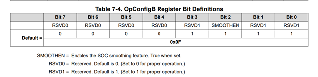

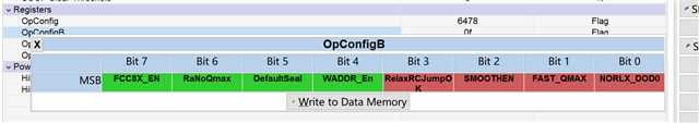

BQ27427: BQ27427 OpConfigB Register is not match with software
Part Number: BQ27427
  BQ27427 datasheet OpConfigB Register is different with software. This device have Relax RC jump function?
The software configB have these register, but datasheet these bit is RSVD1.
