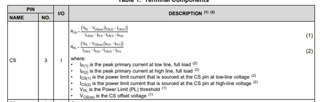

  • in the datasheet a factor of 0.925 is used with tsw, I can understand the entire equation but this specific value, but I can't see the rationale behind it.

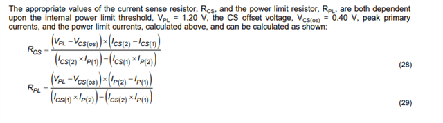

  • also in the datasheet, there is a mismatch between equation for Rcs and Rpl on pages 9 and 26, how are these equations derived exactly?

    When it comes to the equations in the data sheet on page 9 and page 26.  I agree that these don’t match and they may not be correct.

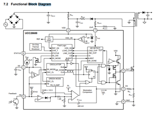

    I reviewed the data sheet and the RPL resistor adds an offset to lower the peak current as the line voltage increases. I reviewed the block diagram and the offset is created by (Iline/2)*RLP.
    Iline = Vbulk*Ns/(Na*ROVP1)
    ROVP1 and ROVP2 are selected based on OVP and startup conditions, so there is no adjustment for these resistors.
    The power limit occurs at CS of 1.2 V.  A good target is size Rcs target would be to set power limit to trip at 125% nominal input power.
    To make things easier you can size Rcs based on the following equation.
    Iline = VBULKmin*(Na/(Np*ROVP1))
    Rcs = ((1.2V-(Iline/2))*RPL)/(Ip(1)*1.25)
