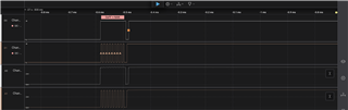

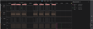

    After another ~10,000 trials, I was able to reproduce this issue again; this time, I had a logic analyzer connected to the I2C bus that supports the TPS25750. It seems the issue happens when our processor briefly pauses in between bytes during the I2C read, as shown below:
    This scenario is uncommon, but it can happen if our processor services another high-priority interrupt for an extended period of time. By monitoring the subtle differences in the clock level, we can confirm that our processor is responsible for the delay, and not the TPS25750:
    After the next-to-last byte is returned, the TPS25750 clock stretches for less than 30 us; this is made apparent by the slightly lower amplitude of the clock (TPS25750 and processor driving in parallel).

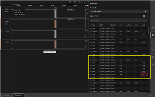

    After that time, the TPS25750 releases the clock; the amplitude increases slightly as only our processor continues to hold the line while it waits to finish the I2C read. By that time, the TPS25750 stopped participating, and the final byte was seen as 0xFF by both our processor and the logic analyzer:
    The delay introduced by our processor between bytes is not ideal, but I expected the TPS25750 to return 0x48 and not 0xFF once our processor finally does drive the final 9 clock cycles. This implies the TPS25750 underwent some kind of reset condition, which leads me to my next question:
    [3] Some parts I've worked with in the past include an I2C watchdog that resets the device internally if the clock is idle too long in between start and stop conditions; is there any chance the TPS25750 includes a similar function?

    Confirmed with team, if there is abnormal behavior on the I2C lines TPS25750 has an internal timer of ~175ms. If the EC needs to go process something else in the middle of the read-back, it's recommended to add a STOP bit, when TPS25750 receives a STOP bit it'll hold onto the remaining data and wait until the I2C master comes back and finish the remaining task. Otherwise without the STOP bit, TPS25750 will clear the data once the timer expires and the EC will either need to re-read the MODE register again or used whatever data it was able to receive previously.

    In the meantime, I have implemented a workaround that retries the read to the MODE register a finite number of times in case one or more unexpected bytes are returned. After several days of continuous testing, the problem reproduced; I am happy to report that the second read (with no delay between bytes) was successful.

    1. There isn't a clear answer as to what the buffer could be, since the read was stopped halfway through it could out the buffer in an abnormal spot causing it to be filled with 0xFF.
    2. In PTCH mode the timeout is set to around 25ms, in APP mode you should see the timeout closer to 175ms.
