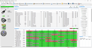

I have designed a new 5S1P Smart pack using BQ40Z80 IC.
We have integrated the design with the pack. When we tried to do the learning cycle the comment given below have been faced.

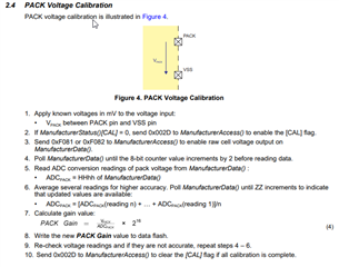

1.The Fuel Gauge IC is able to detect the Device and Showing correct Battery PIN voltage, Both the Pack voltage is completely wrong (The pin Voltage is around 18V ,but the pack voltage is showing 23V).
2.When we tried to calibrate also it is not showing the correct value, When I tried to charge /Discharge the battery the pack is not charging or discharging.
Kindly help us to proceed further on it.
