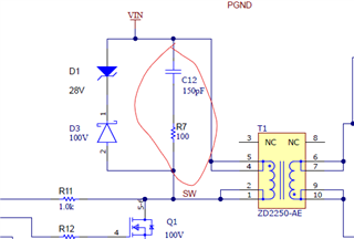

  1. A 100Ohm/150pF snubber on the input side of the transformer (like the evaluation kit):

    -Firstly, could you please share full Schematic and layout? Please, show the EMI filter and schematic used where you got initial results.
    -Is LM5180-Q1 the only DUT/noise source? Is there any other switching component that might add EMI to the readings?
    -Secondly, looking at your results, the noise in the range of 30MHz-100MHz is suspected to be CM noise dominant due to the HF range compared with the fsw. However, DM noise might be present as well.
    -Thirdly, please see bellow an app note that provides CISPR25 Class 5 CE Pass Results. Pay attention to the HF range of 30MHz-100MHz pass results.
    -The schematic and modification made to get pass results are below. Take particular attention to the following:
    a. Y-cap C1 used has 1nF capacitance value. This cap helps to attenuate common mode currents flowing through isolation barrier.
    b. T1 Flyback transformer is shielded and connected to primary ground GND (see picture in app note). Shielding transformer helps to suppress magnetic field coming from air gap from transformer that might be coupling on EMI filter.
    c. Snubber caps increased to 100pF in series with 100ohm resistor. Snubber across switching node positive input and secondary power diode help to mitigate HF harmonics for.
    f. Reducing DM inductor on EMI to 4.7uH and adding an extra 100nF DM cap on EMI pi filter might also help for DM noise. Note that extra 100nF is placed next to LISN.
    g. Finally, I also recommend adding a CMC (common mode choke) to attenuate CM noise too.
    h. Regarding the layout, avoid placing copper under the transformer and EMI filter inductor. Expand your ground planes GND and SGND to improve return connections for the switching loop.
