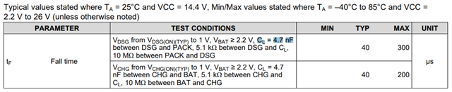

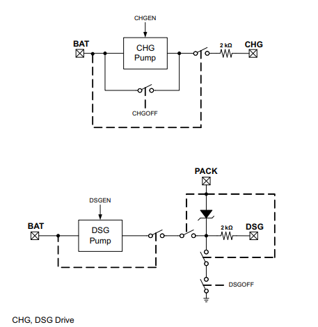

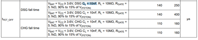

How could I understand the increase CL make Fall time less between BQ40Z50 and BQ41Z50? Where it showed in internal circuit? Thanks!
  • Hi Kailun,
    I believe these are the external test conditions that the specs were based upon. Regarding the DSG Fall Time between these two different hardwares, our hardware team stated:
    "The DSG fall time should be similar on both HW platforms, specially the maximum fall time. Typical values are not fixed values, this is why we include MAX values. "
