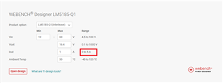

My customer would like to design power supply with below specification.
-  Input : 30V ~ 60V(Typ. 48V)
- output : 24V / 10A, isolated.
Using webench tool, I can get below data. Can I use below design for 240W output?
At TI.com main page of LM5185-Q1, we can see below. current limit is 5A. which one is correct? Do I have to design using 2xLM5185-Q1 for 24V/10A output? How can I design " Interleave" type?
Is there any reference schematic for interleave configuration? please let me know your opinion.
