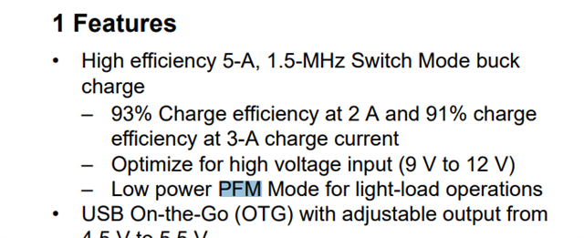

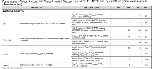

Hi team,
Can you help to update the power consumption of BQ25890 under PFM mode? Thanks!
