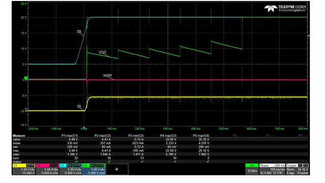

Dear Sir,
The former answer from TI:
When PD Adaptor plug in , TPS25947 is protected
We can not understad that why does TSD trigger , the  TSD spec. Tj is 154 degree C
And the max. inrush current is only about 4.41A  which is event smaller than O.C.P setting (6A)
By the way we have another QA:
1. What is the O.C.P delay time ? (When output current reach 6A remain how long then protect)
2.  Will TPS25947 skip the inrush current protection which  duration is < 100us ?
C1 EN
C2 CURRENT
C3 VIN
C4 VOUT
Thanks and best regards,
Bryan
  • Hi Bryan,
    Power dissipation across the device is Vin-Vout*I. Now here Vin = 20V but Vout is low. For example, during the startup, the Vin - Vout * Current will be 20V- 10V * 5A = 50W. If you check the time to TSD graph, device will go into TSD within 0.2ms.
    Will depend on itimer pin setting.
    Here, it doesn't look like the device is shutting down and doing retry due to current limiting but rather due to TSD.
    Arush
