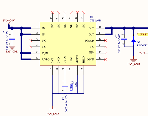

TPS1663: Review schematic
Part Number: TPS1663
Hi team,
pls help review the schematic. thanks
  • Hello Jimmy,
    Please follow the suggestion below
    1.Don't connect SHND to GND. Device will not start. Please leave it floating if you don't intent to use it.
    2.connect 800K resistor to Input and UVLO to reduce the leakage current because of UVLO pin.
