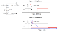

If WDI is input while WDO is outputting low, Trst becomes longer than the set value (200 ms)
Will Trst be extended if WDI is input while WDO is low?

Hello Hirotsugu,
Are you able to provide the schematic for this design? Is the Trst also 10s for the late fault as well?
Jesse
Hi Jesse,
A simple circuit diagram and the phenomenon are attached.
I have attached a simple circuit diagram and an example of the phenomenon.
Normally, WDI is not input while WDO is low, but I confirmed this phenomenon while debugging.
The data sheet does not describe what happens if WDI is input while WDO is low, so please tell me what behavior occurs.
There are older SVS products with WDT function that latch off when a similar operation is performed, but what happens with the TPS3430?
Hi Hirotsugu,
Please refer to to table 5-1 of the datasheet for the behavior.
For the the issue, I will have to double check with my EVM. Do you happen to have the evm for this device?
https://www.ti.com/tool/TPS3430EVM
Jesse

Hi Hirotsugu.
I have tested the TPS3430EVM with the result picture below.
Jesse
Hi Jesse,
Thanks for testing.
What is the Trst time setting (CRST terminal)?
Could you please test again with the CRST terminal open?
The CRST is 10nF, default on the EVM board, which gave me roughly 32.6ms.
I will test with CRST open and provide data end of day.
