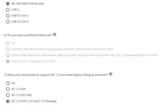

I have a design based on the above components. There is an MCU writing the binary to the TPS25750 on boot. When using USB C to USB C charging, both standard USB C charging and PD charging work as expected.
When plugging in USB A devices however, the current is always ~400-500mA of draw, indicating no USB A charge profiling is occurring. This is true regardless of the five or so different USB A ports I have tried, with current outputs advertised in the 1-2.4A range.
I believe I have the app configured correctly for the TPS to determine advertised current draw from USB A devices:
I have the D+ and D- lines connected directly to the TPS25750's GPIO4+GPIO5 pins from the USB C port. There was ESD protection on these pins, that I have removed, but the effect still remains.
Any advice?

  • Hi Aya,
    Yes here is the config JSON. I have tried both the 'old' and 'new' online config tool.
    The site is not letting me attach files, so I have pasted it below. Thanks:

  • Hi Aya, we have some results on the TPS to BQ I2C initialization on startup.
    The order of registers being written to the BQ from the TPS, are below:

  • Hi Jesse,
    Thank you for your patience.
    We are recommending the TPS25751 for all new designs. There are a couple of know issues found in the TPS25750 that are addressed in the TPS25751 specifically with the PD + battery charger pairing. Please see the following FAQ for more information.
