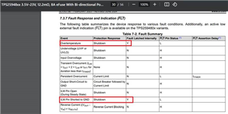

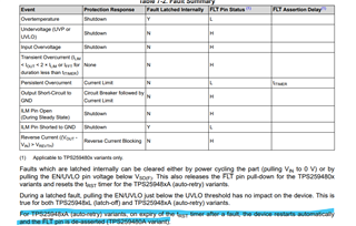

According to the table 7-2 in the datasheet, fault latched internally events will be "over temperature" and ILIM pin shorted to GND".
If TPS259480 is auto retry option, whether it will auto retry to recovery after over temperature condition is unleased?
