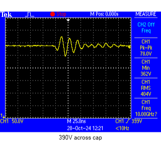

The high-side MOSFET in the half-bridge is driven using a bootstrap circuit. When the gate voltage is probed with Q18 connected and Q17 not connected (NC), the observed behavior is as shown below. Could you suggest potential reasons for this behavior? Your insights would be greatly appreciated.

    I have ruled out probing issues and confirmed that the high-side and low-side supplies of the gate driver are properly isolated. If Q17 and Q18 are not populated, we only observe the gate signal of the low-side MOSFET (Q18) since the bootstrap path required to power the high-side MOSFET remains incomplete.
    Given this, the issue I am experiencing on the board is likely related to the PCB layout.
    Please find the attachments,
    The above attached image is the actual dc link voltage across the half-bridge!

    What does the high-side output waveform look when both Q17 and Q18 are disconnected?
    Sorry for the confusion on this request. I wanted to see the gate driver switching behavior with no load connected since the waveform screenshot of the output seemed very abnormal.
    Is this occurring on more than 1 gate driver unit? I would recommend you to try an ABA swap test to see if the issue is specific to the board or to the device.
