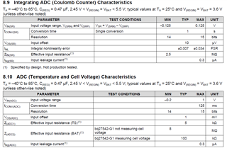

Q1:
Does “Conversion times” in “characteristics” refer only to conversion times?
Or does it include sampling time?
If not, how long is the sampling time?

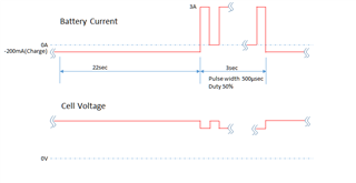

Q2:

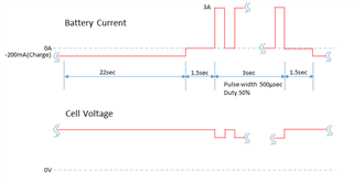

If there is a battery current and cell voltage like the attached “Current wave form”, I think the phase shift between the battery current and cell voltage due to the conversion time will cause an error in the FCC calculation, is this correct?
Q3:
In order to prevent errors due to phase shift, I would like to set a pause time between the charging current (-200mA) and discharging current (3A Pulse).
Since the conversion time is 1 sec, I would like to set it to 1.5 sec to give a margin of error.
Is this correct?(Attachment: Pause time added)
