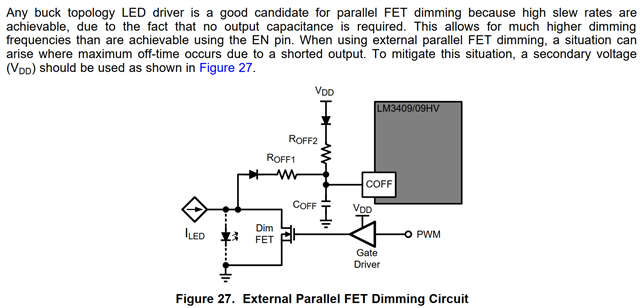

Now I would like to upgrade the LED driver for higher current application. However, because of the issues of the component heating and efficiency, I have to use  Synchronous Buck topology. Therefore, TPS92641 is my first candidate.
To evaluate its performance, I tested the TPS92641EVM board. Based on my test results, the dimming curve is roughly linear, but it becomes unstable and not smooth in the middle range (5%–65%).
According to my experience with LM3409HV, This issue happened before, but it can be resolve by using the below circuit from its datasheet (LM3409HM page 17):
I understand that the values of ROFF1, OFF2 and COO are very critical, if these values are calculated and selected well, then this dimming issue can be resolved.
Now my question is: Can this circuit be applied to the TPS92641? Since the TPS92641 does not have a COFF pin for OFF-time programming, I would like to confirm whether a similar solution can be implemented.
Thank you for your time! Any opinions or suggestions are welcome!
    You cannot, and also do not need to, implement a similar solution in TPS92641.
    TPS92641 implements controlled on-time architecture, whereas LM3409 implements controlled off-time architecture.
    The architecture of LM3409 makes it necessary to add above additional circuitry if you want to use shunt dimming with it. If there is no such circuitry, when all LEDs are short, the C_OFF will never be charged up to the threshold that can end the off cycle until t_OFF-MAX (Maximum OFF-time, check Section 7.5 Electrical Characteristics from LM3409’s datasheet) is triggered. At this time, the output current is out of regulation in the switching-off period (In the switching-on period, the output current is still under the peak current control). You need the above additional circuitry to force the OFF timer to react earlier before t_OFF-MAX is trigged, which will make the output current still under regulation.
    With TPS92641, when all LEDs are short, the ON timer still works as expected thanks to the feedback (R_VOUT1, R_VOUT2, VOUT pin) from the output node. In the switching-off period, the output current is still under the valley current control. So TPS92641 does not have the problem of running out of control when all LEDs are short. Therefore, no additional circuitry like LM3409 is needed.
