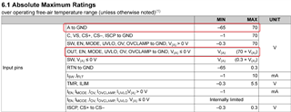

    I also have a question about the image below.
    For example, if the voltage between "A" and "GND" is -20V, is it correct to understand that the voltage range between "OUT" and "GND" is -20V to 50V (70+(-20)=50)?
    Thank you.
  • Hi Masamu,
    You can get the required information from manufacturer.
    Yes, your understanding is correct regarding the ratings.
