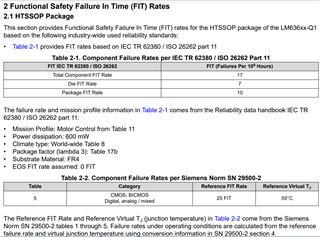

Regarding LM63625DQPWPRQ1, FuSa document shows that the FIT is 17(IEC TR 62380/ ISO26262) or 25(SN 29500-2).
But the estimator shows very low FIT. I'm suspecting that applied mission profile is different from each other. If yes, is there any correlation(equation) between them?
