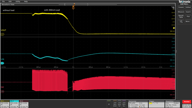

  • Hi Travis,
    Please find the below image, Could you mention which part of Vout you wanted to be zoomed in?
    This waveform is taken using TPS61021A-PWR723 Evaluation Module under 350mA load
    Could you confirm that if we can use the same converter with AAA battery as input(Voltage from 1V to 1.5V) as 3.3V/3V output under 500mA load, with affecting the output voltage?
    Also, please note when 2.5v is given as input the output voltage drops to 2.9v(which is expected to be 3.3v)
  • Hi Nivethitha,
    From the waveform, we can see that the VIN drops before VOUT. So I think the input rail has large internal resistance or low current limit and cannot support  that output power.
    Travis
  • Yes, Vin drops immediately after the load, but the evaluation module is supplied from 3A,DC power supply.
    Vout delay in drop can be of output capacitor?
    How will it behave with battery as input, wont it be able to deliver required load current for eg.(350mA atleast)?
  • Hi Nivethitha,
    Maybe the 3A DC power supply have terrible transient performance. Please apply bulk capacitor over 200uF on the input side and see whether the VIN still drops.
    The 22uFx2 output capacitor cannot hold Vout for over 600us.
    About battery input, this depends on your internal resistance. If the battery has terrible internal resistance, it'll still encounter such Vin_drop -> device_reset problem. You can calculate the maximum output power of battery by (Vbat_open)^2/(4*Rin)
    Travis

  • Hi Nivethitha,
    This picture is captured under below condition:
    Vin1V Vout3.3V Iout 0A->500mA->0A
    CH1: VIN
    CH2:SW
    CH3: VOUT
    CH8:Iout
    I think TPS61021 suits this application well. If the VIN drop rapidly when load is applied, then other IC cannot work normally as well.
    Travis
