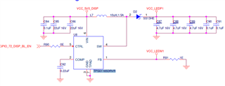

Hi team,
We are using a pin which can be controlled either as GPIO or PWM to control the LED Driver.
When we drive it as IO and make it High, the output voltage of the driver is around 12V with display connected.
But when we drive with PWM, the output voltage changes between 5V and 12.6V - So my display is turning ON and OFF continously.
Below is the circuit we are using.
