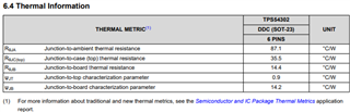

Dear TI team,
Is the thermal resistance value listed in the “Thermal Information” section of TI’s TPS54302 typical or maximum?
Taroimo
Dear TI team,
Taroimo
Hi Taroimo,
It's the typical value. Thanks.
