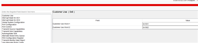

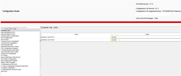

  • Hi Kevin,
    Thanks for the response!
    We tried to check in the customization tool and updated the customer use register value.

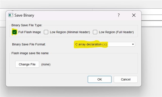

    However, our requirement is to flash the firmware using i2c. For that we are generating the .c file through the tool, include the register data in a header file and flash that through some utility with the help of fourcc commands.
    Sharing the steps followed  below for more detail:
    1. We have set some value(Hex value) in customer use resgister (0x06) in Application customization Tools check attached image.
    2. We have generated .c file,copy that array in to some header file let's say xyz.h file which we use in other .c file where we have implemented 4CC commands.
    3. Compiled the source and generated the binary.
    4. pushed the binary on the device and executed it to flash the TPS controller
    5. After flashing the fimware, checking 0x06 regitser value.

  • Hi Niraj,
    / # i2cget -f -y -a 4 0x20 0x06 i 8
    0x08 0x08 0x02 0x00 0x00 0x00 0x00 0x00
    Can you confirm the value of the 0x6 register before?
    I have not seen any issues with updating this register and creating a new binary with changed values should not have any issues since our FW does not overwrite this register.
    On an EVM using debug mode flashing a new config I am able to see this register value change.

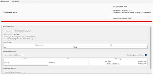

    Note that, we are not directly generating bin file from USB PD Tool. We are generating the .c and .h files and using that data in our utility
    which writes that data using fourcc commands.
    Please refer below steps for reference:
    snapshot 1 : general settings
    snapshot 2 : 0x06 register value
    snapshot 3 : save Binary as a c file
    We have created flashing utility by taking reference note from below link
    TPS65982 FW Update from Embedded Controller Over I2C (Rev. A)
    So as per our understanding, it would not be possible to update the register value through the fourcc commands as the register is read only and can only be updated through the tool and only way to have the register value updated is by flashing the binary generated through the customization tool.
