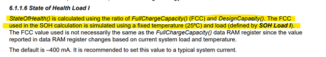

  3. According to the TRM, SOH is calculated as:  FCC(25°C, SOH Load I) / DesignCapacity()
    This formula appears to apply during discharge, but is a different calculation method used during charging?
    How is FCC(25°C, SOH Load I) calculated, and what is its relationship with the SOH Load I setting?

    3.Yes, the SOH is heavily based on the discharge and not really much on the charge cycle (the algorithm can note if it take less time to charge a cell in the same setting than it's capacity is lowered meaning that the cell has a lower SOC). But typically SOH is taken during the discharge and compared to it's ChemID to see what it discharge curve should look like. I would read the mention document above to get a better understanding of how impedance tracking algorithm works.
