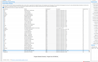

I'm just following up on addition of the MOLICEL INR21700-P50B to the chemistry database. which was discussed in the linked thread.
Have these been added yet?

Hello Daniel,
The Chem ID of MOLICEL INR21700-P50B is 7881, this is a recent addition to the database so you may need to make sure that you BQStudio has the most up to date ChemID. I've attached instruction on how to update your BQStudio to see this on your end.
https://software-dl.ti.com/app_bms/bms-bgp/GASGAUGECHEM-SW/sluuc94ChemUpdateManual.pdf
