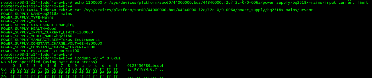

    My test :
    echo 1000000 > /sys/devices/platform/soc@0/44000000.bus/44340000.i2c/i2c-0/0-006a/power_supply/bq2518x-mains/constant_charge_current
    cat /sys/devices/platform/soc@0/44000000.bus/44340000.i2c/i2c-0/0-006a/power_supply/bq2518x-mains/constant_charge_current
                    POWER_SUPPLY_CONSTANT_CHARGE_CURRENT=370
    echo 1000 > /sys/devices/platform/soc@0/44000000.bus/44340000.i2c/i2c-0/0-006a/power_supply/bq2518x-mains/constant_charge_current
                    POWER_SUPPLY_CONSTANT_CHARGE_CURRENT=770

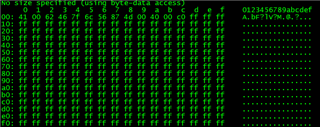

    i2cdump -y -f 0 0x6a
                    root@imx93-14x14-lpddr4x-evk:~# i2cdump -y -f 0 0x6a
                    No size specified (using byte-data access)
                            0 1    2   3   4   5   6   7   8   9   a   b   c  d e f    0123456789abcdef
                    00: 61 00 00 00 7f 20 56 87 07 11 60 00 c0 ff ff ff   !@B.@ V???`.?...
                    10: ff   ff   ff   ff    ff   ff   ff   ff   ff    ff  ff    ff   ff  ff ff ff ................
                    20: ff   ff   ff   ff    ff   ff   ff   ff   ff    ff  ff    ff   ff  ff ff ff ................

  • Hello Jason,
    I see what's happening here.
    The driver isn't converting a physical current value (in uA) into the proper register code. Instead, it writes the value directly into the register. Later, when reading back, the "get" function converts that 7-bit register code (which is in the range 0-127) back into a physical current using a specific formula.
    The driver's range check in the "set" function uses:
    • Minimum: BQ2518X_ICHG_MIN_UA = 5
    • Maximum: BQ2518X_ICHG_MAX_UA = 1000
    This means the driver is not intrepreting the written value as a physical current in uA; it treats the value as an ICHG code (a register value).
    When you read back the current, the process is as follows:
    1. The driver masks the ICHG_CTRL register to extract the "ichg_code."
    2. If (ichg_code + 5 ) ≤ 35, it computes:
      • current = ichg_code + 5
    3. Otherwise, it computes:
      • current = 40 + ((ichg_code - 31) * 10)
    For example:
    • If the register holds a code of 64:
      • Calculation: 40 + ((64 - 31) * 10) = 40 + (33 * 10) = 370
    • If the register holds a code of 104:
      • Calculation: 40 + ((104 - 31) * 10) = 40 + (73 * 10) = 770
    The register field uses a 7-bit mask (BQ2518X_ICHG_MASK = 0x7f), so only the lowest 7 bits of any written value are stored. In other words, any number larger than 127 is reduced to its remainder when divided by 128, which is mathematically equivalent to taking the number modulo 128.
    For example:
    • Writing 1,000,000:
      • 1,000,000 mod 128 = 64, so 64 is stored in the register.
    • Writing 1000:
      • 1000 mod 128 = 104, so 104 is stored in the register.
    That's why you see the values 64 and 104 in the register, which the "get" function converts to 370 and 770, respectively. Essentially, the value echoed isn't being converted from uA into a proper register code; it's just being reduced to a number between 0 and 127.
    Alec

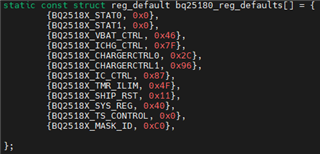

  • Hi Alec,
        Could you help to update the driver for the issues above ? Now, I'm writing to the register by command of i2cset, otherwise if it is configured by DTS, the register value will not match the datasheet after driver running.such as :
    static int bq2518x_set_batt_reg(struct bq2518x_device *bq2518x, int val)
    int vbat_reg_code;
    int ret;
    if (val > BQ2518X_VBAT_REG_MAX || val < BQ2518X_VBAT_REG_MIN)
    return -EINVAL;
    ret = regmap_read(bq2518x->regmap, BQ2518X_VBAT_CTRL, &vbat_reg_code);
    if (ret)
    return ret;
    vbat_reg_code = ((val - BQ2518X_VBAT_BASE_VOLT) / BQ2518X_VBAT_STEP_UV) &
    (vbat_reg_code & BQ2518X_PG_MODE);
    return regmap_write(bq2518x->regmap, BQ2518X_VBAT_CTRL, vbat_reg_code);
  • Hello Jason,
    I have updated the set function to properly convert the physical current value (in mA) into the register code (ichg_code) expected by the hardware. The updated naming now reflects that the values are in mA. Below is the new set function code:
    #define BQ2518X_ICHG_MIN_MA 		5
    #define BQ2518X_ICHG_MAX_MA 		1000
    #define BQ2518X_ICHG_MIN_STEP		5

    3. I updated default value, and comment "bq2518x_hw_init", but the register value was still modifed, such as BQ2518X_ICHG_CTRL, BQ2518X_CHARGERCTRL1, BQ2518X_IC_CTRL and BQ2518X_IC_CTRL. Could you tell me where else changed the value of  register except "bq2518x_hw_init" ?
  • Hello Jason,
    Even if you comment out bq2518x_hw_init(), the regmap default cache still applies. The driver has an array of "default" register values (bq25180_reg_defaults[]), and regmap writes these to the hardware on probe — regardless of whether bq2518x_hw_init() is called. That explains why you're still seeing the registers change from their true silicon defaults.

  • Hello Alec,
    With the changes above, register values are shown below
    However, the values I expect are shown below:
    Please help to check whether the dts configuration is correct. How should I configure to get the register values I want ?

  • Hello Jason,
    Thanks for your patience as we work through this.
    It seems that Reg0x4, Reg0x6, Reg0x7, and Reg0x8 are not being set correctly, meaning that ICHG, BATOCP, Watchdog, and ILIM aren't being configured as expected.

    1. I noticed from your previous reply that you have {BQ2518X_IC_CTRL, 0x87} in reg_default. It seems possible that Reg0x7 is being set to 0x87, then the logic of bq2518x_disable_watchdog_timers() is flipping the watchdog bits ([1:0]) back to 00, which is causing Reg0x7 = 0x84. I recommend setting {BQ2518X_IC_CTRL, 0x84} to see if this causes Reg0x7 to set properly.
    Fix Reg0x6 (BATOCP bits):

  • Hi Alec,
    Thanks for your support !
    With the changes you suggested , register values are shown below:
    only battery power
    It seems that Reg0x4, Reg0x6, Reg0x7, and Reg0x8 are being set correctly, but it seems that Reg0x3 is not correct .

  • Hi Alec,
    I'm very sorry to tell you that I forgot to delete the script which automatically configured the registers, so the result last time was the role of the script rather than the role of modifying the code. I deleted the automatic script and reconfirmed the register values:
    With the changes, Reg0x7 has been configured as expected. The values of other registers have changed but have not yet reached the expected value.

    static const struct reg_default bq25180_reg_defaults[] = {
    	{BQ2518X_STAT0, 0x0},
    	{BQ2518X_STAT1, 0x0},
    	{BQ2518X_VBAT_CTRL, 0x46},
    	{BQ2518X_ICHG_CTRL, 0x7F},
    	{BQ2518X_CHARGERCTRL0, 0x2C},
    	{BQ2518X_CHARGERCTRL1, 0x96},
    	{BQ2518X_IC_CTRL, 0x84},
    	{BQ2518X_TMR_ILIM, 0x4F},
    	{BQ2518X_SHIP_RST, 0x11},
    	{BQ2518X_SYS_REG, 0x40},
    	{BQ2518X_TS_CONTROL, 0x0},
    	{BQ2518X_MASK_ID, 0xC0},

  • Hello Alec,
    Added the debugging code above and the following information was printed :
    It seems that something else is overwriting them. Where modified the two registers after bq2518x_hw_init() ?
    Thanks.

  • Hello Jason,
    I notice from the STAT registers that the device is in TS HOT and DPPM. Could you try removing the input source and then reading the registers again?
    Also, could you add bq2518x_disable_watchdog_timers() back into hw_init() to see if that prevents the registers from resetting?
    Finally, I'm curious about your reg_defaults array—could you share those values as well?
    Alec
  • Hello Alec,
    I added bq2518x_disable_watchdog_timers() back into hw_init()  and removed the input source, then read the registers :
    my reg_defaults array :
    Thanks.

    I tried writing ILIM and BATOCP while the adapter was connected and then read them back, they stayed at the configured values instead of being reset.
    I think the registers will be reset to "reg_defaults" when watchdog timer expires. However, the default values of Reg0x06 and Reg0x08 in "reg_defaults" are 0x96 and 0x4F. On the other side, the reset values of Reg0x06 and Reg0x08 are defined as 0x56 and 0x4D in datasheet. Does this mean Reg0x06 and Reg0x08 were reset by hardware? Could you think about what would trigger a hardware reset ?
     I have not found anything referencing CHARGERCTRL1 (Reg0x06) or TMR_ILIM (Reg0x08) in my codebase, could you please give me some suggestion to solve this issue ?
    Thanks.
  • Hello Alec,
    In addition, Reg0x06 and Reg0x08 were overwrited after insmoding driver. After that, if reverting to 0x96 and 0x4D with "i2cset", they will not been overwrited again.
    Thanks.
  • Hello Jason,
    Thanks for the information.
    Yes, given that Reg0x06 and Reg0x08 are reset to their hardware default values (0x56 and 0x4D) instead of reg_defaults (0x96 and 0x4F), it seems that they are being reset by hardware. There are a few ways that the BQ25180 can reset its registers to their default values:

    I tried the following test:
    cat /sys/devices/platform/soc@0/44000000.bus/44340000.i2c/i2c-0/0-006a/power_supply/bq2518x-mains/uevent
    POWER_SUPPLY_INPUT_CURRENT_LIMIT=1100000,
    It appear that the instruction does not dynamically refresh, so the printed information does not match the register value.
    echo 1100000 > /sys/devices/platform/soc@0/44000000.bus/44340000.i2c/i2c-0/0-006a/power_supply/bq2518x-mains/input_current_limit
    echo 700000 > /sys/devices/platform/soc@0/44000000.bus/44340000.i2c/i2c-0/0-006a/power_supply/bq2518x-mains/input_current_limit
