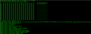

    I have changed BQ2518X_CHG_STAT_STEP from 4 to 5. But it doesn't seem to see any change. I'm not sure if POWER_SUPPLY_STATUS can accurately reflect the battery charging status in real time, because it keeps showing "Not charging".
    Thanks.

    Could you try:
    cat /sys/class/power_supply/bq2518x-mains/status
    Does this show the correct charging state in real time?

    The execution results of commands "cat /sys/class/power_supply/bq2518x-mains/status" and "cat /sys/devices/platform/soc@0/44000000.bus/44340000.i2c/i2c-0/0-006a/power_supply/bq2518x-mains/uevent" are the same about POWER_SUPPLY_STATUS.
    I found that after unplugging and plugging the battery, I could see "POWER_SUPPLY_STATUS=Charging". About one minute later, "POWER_SUPPLY_STATUS=Unknown" and Reg01 changed from 0x39 to 0x01.  Another minute later, "POWER_SUPPLY_STATUS=Not charging", and Reg01 changed from 0x01 to 0x61. Then Reg01 varied among 0x61, 0x51 and 0x41, but "POWER_SUPPLY_STATUS=Not charging" no longer changed.
