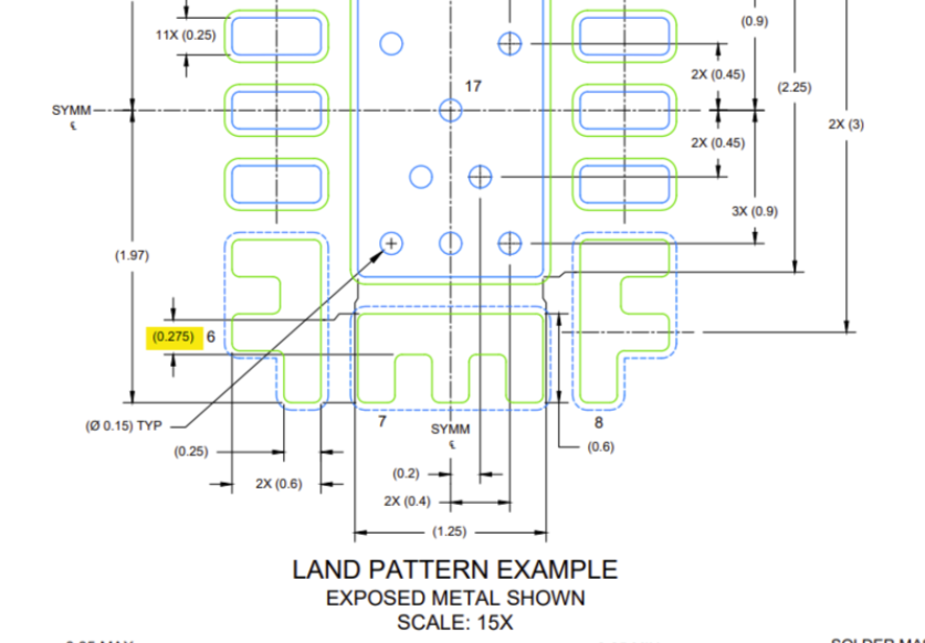

Would you please provide us below footprint red mark size?

Pin size will be symmetric on mirror side. So, you can consider similar value as define on other side.
Please also take a look on package files on product folder: https://www.ti.com/product/TPS62872-Q1 where you have more detail data like step / cad model. It can help you if you plan to design PCB.
Can you share more details about project and EE where plan to use this device?

Land pattern should be the correct one. I looking it with internal package expert why it is mismatching and check the correct dimension.
I will give more insight before end of this week.
