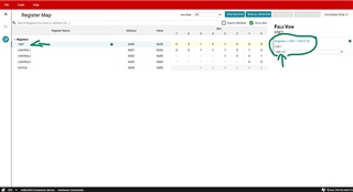

    I assume your customer use the GUI like this to choose the step and Vset:
    Here the Vset is not updated directly after changing the voltage steps. One way to solve it is to drag the Vset bar a little bit to actually 'update' the output voltage.

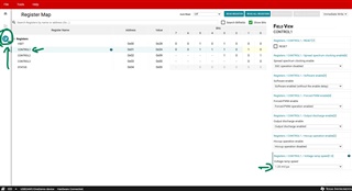

    But I would recommend to directly choose the step and Vset from the register page, as shown below. Here we can write data into the register for sure.
    Or, if possible, customer can also choose the 10mV steps, which can support output voltage from 0.8V to 3.3V.
