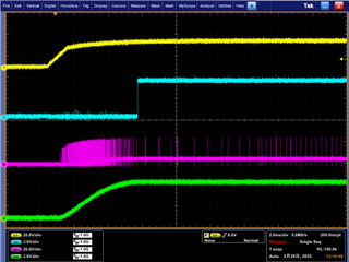

When the PG terminal of the TPS56A37 rises, it shows the following waveform.
Is it possible that the IC is the cause of the waveform shown below?
(CH2: PGOOD, CH3: +5V)

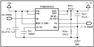

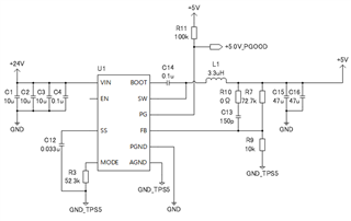

The circuit diagram is as follows, with PG terminal connected to the EN terminal of the TPSM82903SISR.
