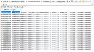

The current project is based on modifying the example firmware, and the intended control actions have been successfully implemented.

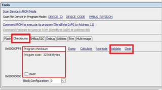

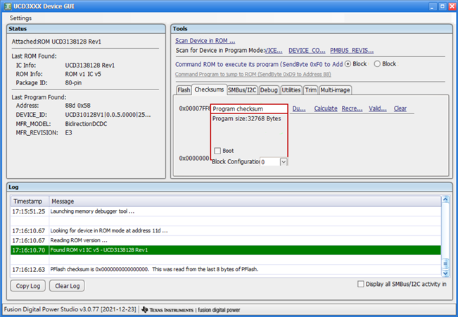

However, when I attempt to use "WRITE program checksum" to program the PFLASH (following the flashing procedure described in the attached documentation), the checksum cannot be cleared when trying to switch back from PFLASH to ROM mode. As a result, the system remains in PFLASH mode. At this point, PMBus communication is functional, and the system operates normally, leading me to suspect that the "checksum clearing" operation was not fully executed.
Current workaround: Using JTAG to manually clear the flash. However, this is not the best solution.
Since the original firmware includes the zero_out_integrity_double_word() function, why is it not executed properly?
Bidirection DCDC Converter User Guide.pdf

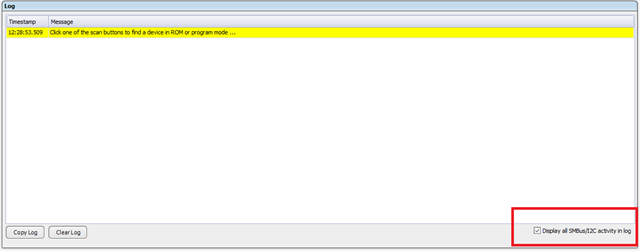

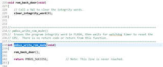

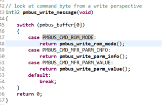

Clicking "Jump to ROM" does not clear the checksum, and it remains in PFLASH mode.
software_interrupt ,case 12:

					}        //execute erase checksum
					DecRegs.MFBALR1.bit.RONLY = 1; //restore it to read only
					DecRegs.MFBALR17.bit.RONLY = 1; //restore it to read only
		            SysRegs.SYSECR.bit.RESET = 2;   //now reset processor.
					break;

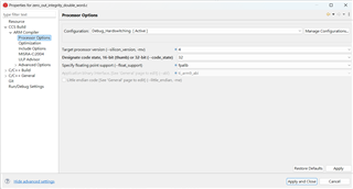

#pragma CODE_STATE(zero_out_integrity_double_word, 32)  // this will ensure that this code builds in ARM mode
void zero_out_integrity_double_word(void) //clears integrity double word at address. using flash key provided

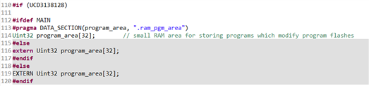

variables.h , program_area:

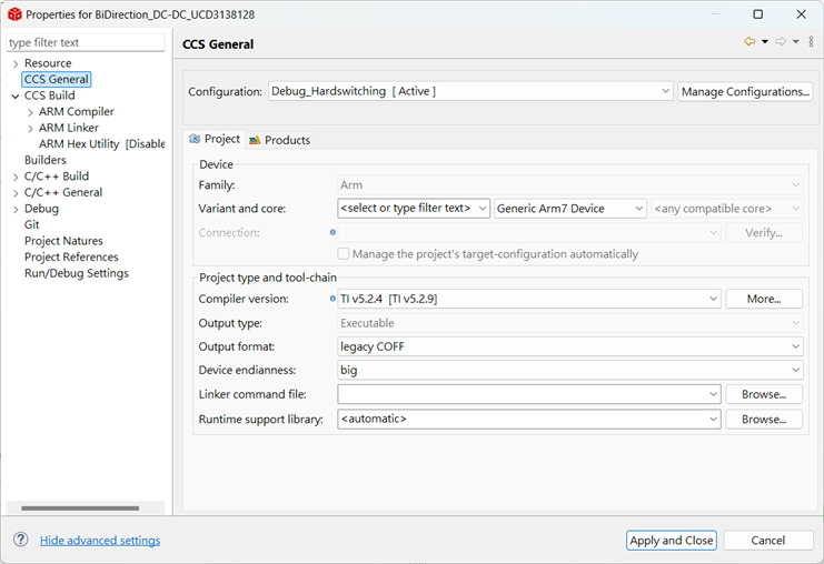

  • Development software used: Code Composer Studio Version: 12.7.1.00001
  • Hi Parrish,
    Can you please check the following?
    After trying to switch back from PFLASH to ROM mode, whether under 'checksums' tab, 'validate' or 'clear' option is active or not. If yes, you can click on validate to see whether the checksum is cleared or not (it will be all zeros if cleared) and if not cleared you can click on 'clear' to clear the checksum.
    Please let me know if these options are inactive too.
    Deepak K

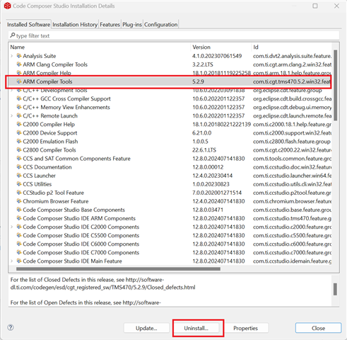

    Compiler version : v5.2.9

  • Hi Parrish and Ian,
    I can see the checksum value is becoming all zeroes in the logs (image shared by Parrish) after clicking on 'clear' option. So, checksum is getting cleared by the PMBus command. Please help me to understand the problem better.
    Deepak K
    The description you provided above only applies to reading and clearing the checksum in ROM mode.
    The main issue is that the checksum cannot be properly cleared while in PFLASH mode. As a result, when the chip restarts, it enters PFLASH mode and cannot remain in ROM mode.
    So when I use the firmware download "Write Checksum" function, the system remains locked in PFLASH mode. What I mainly want is to be able to restore from PFLASH to ROM mode.
  • Hi Parrish,
    I tried to reproduce the problem from our end and we are getting desired result.
    I want to get few more info from your end.
    1) Once you download the firmware to controller, please confirm whether after clicking on 'Command program to jump to ROM', the options under checksums tab are active or inactive, if active, you can clear checksum directly by using 'clear' option.
    2)If the options are not active, PMBus is sending 'D9' command to clear the cheksums and it is not executing. This is how the 'D9' command works,
    Once GUI sends D9, firmware execute following code (Please refer pmbus.c file in your firmware),
    int32 pmbus_write_message(void)
    	switch (pmbus_buffer[0])
    		case PMBUS_CMD_ROM_MODE:
    			return pmbus_write_rom_mode();
            case PMBUS_CMD_MFR_PARM_INFO:
            	return pmbus_write_parm_info();
    		case PMBUS_CMD_MFR_PARM_VALUE:
    			return pmbus_write_parm_value();
    		default:
    			break;
    	return 0;
    PMBUS_CMD_ROM_MODE has the value D9 and that particular case will get execute and following is the code which is getting executed (Please refer pmbus_manuf_specific_commands.c file in your firmware).

    And room_back_door() function has the following code(Please refer pmbus_manuf_specific_commands.c file in your firmware).
    void rom_back_door(void)
    	// Call a SWI to clear the integrity words.
    	clear_integrity_word(0);
    Finally, clear_integrity_word() function is in the interrupt.c file with case 12 as you mentioned earlier. Can you please confirm, in your firmware, this code flow is not broken anywhere and it is intact. If you are not able to find an issue in above code flow, please share the log screenshot after clicking on 'Command program to jump to ROM'. Please select the check box for 'Display all SMBus?I2C activity in log option'. Please refer attached screenshot
    Deepak K
    Here is a screenshot of my code segment: it matches what you provided.
    the software_interrupt function has been compared with the original file, and the code is consistent.
    The software_interrupt function, case 12:

    		register Uint32 * program_index = (Uint32 *) program_area; //store destination address for program
    					register Uint32 * source_index = (Uint32 *) zero_out_integrity_double_word; //Used for source address of PFLASH;
    					register Uint32 counter;
    					if(arg1 == 0) //0 means first block in memory, regardless of which block that is;
    						zoiw_address = 0x7ff8;
    						if((DecRegs.MFBALR1.bit.ADDRESS == 0) && (DecRegs.MFBAHR1.bit.ADDRESS == 0)) //here if flash block 0 is at 0
    							zoiw_flash_key = PROGRAM_FLASH0_INTERLOCK_KEY;
    						else if((DecRegs.MFBALR17.bit.ADDRESS == 0) && (DecRegs.MFBAHR17.bit.ADDRESS == 0))//if it's program flash 1;
    							zoiw_flash_key = PROGRAM_FLASH1_INTERLOCK_KEY;
    						else if((DecRegs.MFBALR18.bit.ADDRESS == 0) && (DecRegs.MFBAHR18.bit.ADDRESS == 0))//if it's program flash 2;
    							zoiw_flash_key = PROGRAM_FLASH2_INTERLOCK_KEY;
    						else if((DecRegs.MFBALR19.bit.ADDRESS == 0) && (DecRegs.MFBAHR19.bit.ADDRESS == 0))//if it's program flash 3;
    							zoiw_flash_key = PROGRAM_FLASH3_INTERLOCK_KEY;
    						else
    							return;
    					else if(arg1 == 1)//1 means end of second block;
    						zoiw_address = 0xfff8;
    						if((DecRegs.MFBALR1.bit.ADDRESS == 0x20) && (DecRegs.MFBAHR1.bit.ADDRESS == 0)) //here if flash block 0 is at 0x8000
    						//note that the address bits start at bit 10, so 0x20 in the address field equals 0x8000
    						else if((DecRegs.MFBALR17.bit.ADDRESS == 0x20) && (DecRegs.MFBAHR17.bit.ADDRESS == 0))//if it's program flash 1;
    						else if((DecRegs.MFBALR18.bit.ADDRESS == 0x20) && (DecRegs.MFBAHR18.bit.ADDRESS == 0))//if it's program flash 2;
    						else if((DecRegs.MFBALR19.bit.ADDRESS == 0x20) && (DecRegs.MFBAHR19.bit.ADDRESS == 0))//if it's program flash 3;
    						else
    							return;
    					else if(arg1 == 2) //2 means end of third block in memory, regardless of which block that is;
    						zoiw_address = 0x17ff8;
    						if((DecRegs.MFBALR1.bit.ADDRESS == 0) && (DecRegs.MFBAHR1.bit.ADDRESS == 1)) //here if flash block 0 is at 0x10000
    						else if((DecRegs.MFBALR17.bit.ADDRESS == 0) && (DecRegs.MFBAHR17.bit.ADDRESS == 1))//if it's program flash 1;
    						else if((DecRegs.MFBALR18.bit.ADDRESS == 0) && (DecRegs.MFBAHR18.bit.ADDRESS == 1))//if it's program flash 2;
    						else if((DecRegs.MFBALR19.bit.ADDRESS == 0) && (DecRegs.MFBAHR19.bit.ADDRESS == 1))//if it's program flash 3;
    						else
    							return;
    					else if(arg1 == 3)//2 means end of fourth block;
    						zoiw_address = 0x1fff8;
    						if((DecRegs.MFBALR1.bit.ADDRESS == 0x20) && (DecRegs.MFBAHR1.bit.ADDRESS == 1)) //here if flash block 0 is at 0x18000
    						else if((DecRegs.MFBALR17.bit.ADDRESS == 0x20) && (DecRegs.MFBAHR17.bit.ADDRESS == 1))//if it's program flash 1;
    						else if((DecRegs.MFBALR18.bit.ADDRESS == 0x20) && (DecRegs.MFBAHR18.bit.ADDRESS == 1))//if it's program flash 2;
    						else if((DecRegs.MFBALR19.bit.ADDRESS == 0x20) && (DecRegs.MFBAHR19.bit.ADDRESS == 1))//if it's program flash 3;
    						else
    							return;
    					else
    						return; //reject other arg1 values
    					for(counter=0; counter < 32; counter++) //Copy program from PFLASH to RAM
    						*(program_index++)=*(source_index++);
    					DecRegs.MFBALR1.bit.RONLY = 0; //enable program flash 1 write
    					DecRegs.MFBALR17.bit.RONLY = 0; //enable program flash 2 write
    						register FUNC_PTR func_ptr;
    						func_ptr=(FUNC_PTR)program_area;     //Set function to program area
    						func_ptr();
    					break;
    logs:
       1. After trying "Write program checksum" with firmware download and then clicking on 'Command program to jump to ROM', the result is as follows:
    Timestamp	Message
    2025/2/24 下午 04:53:33	Click one of the scan buttons to find a device in ROM or program mode ...
    2025/2/24 下午 04:53:34
    2025/2/24 下午 04:53:34	SAA: SetPullUps (Alert: 2.2 kΩ; Clock: 2.2 kΩ; Data: 2.2 kΩ): ACK
    2025/2/24 下午 04:53:34	Looking for device in ROM mode at address 11d ...
    2025/2/24 下午 04:53:34	Reading ROM version ...
    2025/2/24 下午 04:53:34	SAA: BlockRead (Address 11d, Cmd 0xEC): ACK 0x00050001
    2025/2/24 下午 04:53:34	Reading Dev ID Register  ...
    2025/2/24 下午 04:53:34	SAA: BlockWrite (Address 11d, Cmd 0xFD, 0xFFFFFFF0): ACK
    2025/2/24 下午 04:53:34	SAA: BlockRead (Address 11d, Cmd 0xFA): ACK 0x00003447
    2025/2/24 下午 04:53:34	Reading PKGID ...
    2025/2/24 下午 04:53:34	SAA: BlockWrite (Address 11d, Cmd 0xFD, 0xFFF7F010): ACK
    2025/2/24 下午 04:53:34	SAA: BlockRead (Address 11d, Cmd 0xFA): ACK 0x00000003
    2025/2/24 下午 04:53:34	Found ROM v1 IC v5 - UCD3138128 Rev1
    2025/2/24 下午 04:53:35
    2025/2/24 下午 04:53:35	Launching firmware download tool; pausing detailed SAA/I2C logging ...
    2025/2/24 下午 04:53:35	SAA: BlockRead (Address 11d, Cmd 0xFA): ACK 0x00000003
    2025/2/24 下午 04:53:35	SAA: SetPecMode (PEC): ACK
    2025/2/24 下午 04:53:35	SAA: BlockRead (Address 11d, Cmd 0xEC): ACK 0x00050001
    2025/2/24 下午 04:53:35	SAA: BlockWrite (Address 11d, Cmd 0xFD, 0xFFFFFFF0): ACK
    2025/2/24 下午 04:53:35	SAA: BlockRead (Address 11d, Cmd 0xFA): ACK 0x00003447
    2025/2/24 下午 04:53:50	SAA: BlockRead (Address 11d, Cmd 0xFA): ACK 0x00003447
    2025/2/24 下午 04:53:50	SAA: SetPecMode (PEC): ACK
    2025/2/24 下午 04:53:50	SAA: BlockWrite (Address 11d, Cmd 0xFD, 0x0006A048): ACK
    2025/2/24 下午 04:53:50	SAA: BlockRead (Address 11d, Cmd 0xFA): ACK 0x00000000
    2025/2/24 下午 04:53:50	SAA: WriteByte (Address 11d, Cmd 0xF2, 0x01): ACK
    2025/2/24 下午 04:53:50	SAA: BlockWrite (Address 11d, Cmd 0xF4, 0x00040000EA001437EA000005EA000005EA00016A): ACK
    2025/2/24 下午 04:53:50	SAA: BlockWrite (Address 11d, Cmd 0xF4, 0x00040010EA00016AEA000168EA0011D6EA000173): ACK
    2025/2/24 下午 04:53:50	SAA: BlockWrite (Address 11d, Cmd 0xF4, 0x00040020E1B0F00EE92D4070E10F4000E38440C0): ACK
    2025/2/24 下午 04:53:50	SAA: BlockWrite (Address 11d, Cmd 0xF4, 0x00040030E129F004E1A0C003E59F25A4E59F4580): ACK
    2025/2/24 下午 04:53:50	SAA: BlockWrite (Address 11d, Cmd 0xF4, 0x00040040E59FE5A4E35C00019A00010BE24CC003): ACK
    2025/2/24 下午 04:53:50	SAA: BlockWrite (Address 11d, Cmd 0xF4, 0x00040050E35C000F8A000157E59F3568E59F5584): ACK

          After pressing 'Command program to jump to ROM', the system remains in PFLASH mode. So, I tried using JTAG to read the data at address 0x7FF8 and confirmed that the checksum was not cleared.
       2. After trying 'Do not write program checksum' with firmware download, then clicking on 'Command program to jump to ROM' followed by 'Read checksum', the feedback was: 'PFlash checksum is 0xFFFFFFFFFFFFFFFF.

    2025/2/24 下午 05:00:25	Click one of the scan buttons to find a device in ROM or program mode ...
    2025/2/24 下午 05:01:40
    2025/2/24 下午 05:01:40	Launching firmware download tool; pausing detailed SAA/I2C logging ...

    2025/2/24 下午 05:02:09	       SETUP_ID: VERSION1|BIDI01                  0x56455253494F4E317C42494449303100
    2025/2/24 下午 05:02:09	SAA: BlockRead (Address 88d, Cmd 0x9A): ACK 0x4269646972656374696F6E4443444300
    2025/2/24 下午 05:02:09	      MFR_MODEL: BidirectionDCDC                  0x4269646972656374696F6E4443444300
    2025/2/24 下午 05:02:09	SAA: BlockRead (Address 88d, Cmd 0x9B): ACK 0x453300
    2025/2/24 下午 05:02:09	   MFR_REVISION: E3                               0x453300
    2025/2/24 下午 05:02:09	SAA: BlockRead (Address 88d, Cmd 0x9E): ACK 0x585858585800
    2025/2/24 下午 05:02:09	     MFR_SERIAL: XXXXX                            0x585858585800
    2025/2/24 下午 05:02:09	SAA: BlockRead (Address 88d, Cmd 0x99): ACK 0x464F584C494E4B00
    2025/2/24 下午 05:02:09	         MFR_ID: FOXLINK                          0x464F584C494E4B00
    2025/2/24 下午 05:02:09	SAA: BlockRead (Address 88d, Cmd 0x9D): ACK 0x59594D4D444400
    2025/2/24 下午 05:02:09	       MFR_DATE: YYMMDD                           0x59594D4D444400
    2025/2/24 下午 05:02:09	SAA: BlockRead (Address 88d, Cmd 0x9C): ACK 0x54616977616E2C20545700
    2025/2/24 下午 05:02:09	   MFR_LOCATION: Taiwan, TW                       0x54616977616E2C20545700
    2025/2/24 下午 05:02:09	SAA: BlockRead (Address 89d, Cmd 0xFD): NACK
    2025/2/24 下午 05:02:09	SAA: BlockRead (Address 90d, Cmd 0xFD): NACK
    2025/2/24 下午 05:02:09	SAA: BlockRead (Address 91d, Cmd 0xFD): NACK
    2025/2/24 下午 05:02:09	SAA: BlockRead (Address 92d, Cmd 0xFD): NACK
    2025/2/24 下午 05:02:09	SAA: BlockRead (Address 93d, Cmd 0xFD): NACK
    2025/2/24 下午 05:02:09	SAA: BlockRead (Address 94d, Cmd 0xFD): NACK
    2025/2/24 下午 05:02:09	SAA: BlockRead (Address 95d, Cmd 0xFD): NACK
    2025/2/24 下午 05:02:09	SAA: BlockRead (Address 96d, Cmd 0xFD): NACK
    2025/2/24 下午 05:02:09	SAA: BlockRead (Address 97d, Cmd 0xFD): NACK
    2025/2/24 下午 05:02:09	SAA: BlockRead (Address 98d, Cmd 0xFD): NACK
    2025/2/24 下午 05:02:09	SAA: BlockRead (Address 99d, Cmd 0xFD): NACK
    2025/2/24 下午 05:02:09	SAA: BlockRead (Address 100d, Cmd 0xFD): NACK
    2025/2/24 下午 05:02:09	SAA: BlockRead (Address 101d, Cmd 0xFD): NACK
    2025/2/24 下午 05:02:09	SAA: BlockRead (Address 102d, Cmd 0xFD): NACK
    2025/2/24 下午 05:02:09	SAA: BlockRead (Address 103d, Cmd 0xFD): NACK
    2025/2/24 下午 05:02:09	SAA: BlockRead (Address 104d, Cmd 0xFD): NACK
    2025/2/24 下午 05:02:09	SAA: BlockRead (Address 105d, Cmd 0xFD): NACK
    2025/2/24 下午 05:02:09	SAA: BlockRead (Address 106d, Cmd 0xFD): NACK
    2025/2/24 下午 05:02:09	SAA: BlockRead (Address 107d, Cmd 0xFD): NACK
    2025/2/24 下午 05:02:09	SAA: BlockRead (Address 108d, Cmd 0xFD): NACK
    2025/2/24 下午 05:02:09	SAA: BlockRead (Address 109d, Cmd 0xFD): NACK
    2025/2/24 下午 05:02:09	SAA: BlockRead (Address 110d, Cmd 0xFD): NACK
    2025/2/24 下午 05:02:09	SAA: BlockRead (Address 111d, Cmd 0xFD): NACK
    2025/2/24 下午 05:02:09	SAA: BlockRead (Address 112d, Cmd 0xFD): NACK
    2025/2/24 下午 05:02:09	SAA: BlockRead (Address 113d, Cmd 0xFD): NACK
    2025/2/24 下午 05:02:09	SAA: BlockRead (Address 114d, Cmd 0xFD): NACK
    2025/2/24 下午 05:02:09	SAA: BlockRead (Address 115d, Cmd 0xFD): NACK
    2025/2/24 下午 05:02:09	SAA: BlockRead (Address 116d, Cmd 0xFD): NACK
    2025/2/24 下午 05:02:09	SAA: BlockRead (Address 117d, Cmd 0xFD): NACK
    2025/2/24 下午 05:02:09	SAA: BlockRead (Address 118d, Cmd 0xFD): NACK
    2025/2/24 下午 05:02:09	SAA: BlockRead (Address 119d, Cmd 0xFD): NACK
    2025/2/24 下午 05:02:09	SAA: BlockRead (Address 120d, Cmd 0xFD): NACK
    2025/2/24 下午 05:02:09	SAA: BlockRead (Address 121d, Cmd 0xFD): NACK
    2025/2/24 下午 05:02:09	SAA: BlockRead (Address 122d, Cmd 0xFD): NACK
    2025/2/24 下午 05:02:09	SAA: BlockRead (Address 123d, Cmd 0xFD): NACK
    2025/2/24 下午 05:02:09	SAA: BlockRead (Address 124d, Cmd 0xFD): NACK
    2025/2/24 下午 05:02:09	SAA: BlockRead (Address 125d, Cmd 0xFD): NACK
    2025/2/24 下午 05:02:09	SAA: BlockRead (Address 126d, Cmd 0xFD): NACK
    2025/2/24 下午 05:02:09	SAA: BlockRead (Address 127d, Cmd 0xFD): NACK
    2025/2/24 下午 05:02:09	SAA: BlockRead (Address 88d, Cmd 0xFD): ACK 0x55434433313031323856317C302E302E352E303030307C32353032323400
    2025/2/24 下午 05:02:09	SAA: BlockRead (Address 88d, Cmd 0xE7): ACK 0x56455253494F4E317C42494449303100
    2025/2/24 下午 05:02:09	SAA: BlockRead (Address 88d, Cmd 0xE4): ACK 0x0000000000000000000000000000000000000000000000000000000000000000
    2025/2/24 下午 05:02:09	SAA: BlockRead (Address 88d, Cmd 0xE5): ACK 0x00000000000000000000000000000000000000FE00000000000000403D000004
    2025/2/24 下午 05:02:09	SAA: BlockWrite (Address 88d, Cmd 0xE2, 0x0108030104): ACK
    2025/2/24 下午 05:02:09	SAA: BlockRead (Address 88d, Cmd 0xE3): ACK 0x00000000
    2025/2/24 下午 05:02:15
    2025/2/24 下午 05:02:15	SAA: SendByte (Address 88d, Cmd 0xD9): ACK
    2025/2/24 下午 05:02:15	Pausing 1,500.00 ms for ENABLE_ROM send to ROM hold time
    2025/2/24 下午 05:02:17	SAA: SendByte (Address 88d, Cmd 0xD9): ACK
    2025/2/24 下午 05:02:17	Looking for device in ROM mode at address 11d ...
    2025/2/24 下午 05:02:17	Reading ROM version ...
    2025/2/24 下午 05:02:17	SAA: BlockRead (Address 11d, Cmd 0xEC): ACK 0x00050001
    2025/2/24 下午 05:02:17	Reading Dev ID Register  ...
    2025/2/24 下午 05:02:17	SAA: BlockWrite (Address 11d, Cmd 0xFD, 0xFFFFFFF0): ACK
    2025/2/24 下午 05:02:17	SAA: BlockRead (Address 11d, Cmd 0xFA): ACK 0x00003447
    2025/2/24 下午 05:02:17	Reading PKGID ...
    2025/2/24 下午 05:02:17	SAA: BlockWrite (Address 11d, Cmd 0xFD, 0xFFF7F010): ACK
    2025/2/24 下午 05:02:17	SAA: BlockRead (Address 11d, Cmd 0xFA): ACK 0x00000003
    2025/2/24 下午 05:02:17	Found ROM v1 IC v5 - UCD3138128 Rev1
    2025/2/24 下午 05:02:21
    2025/2/24 下午 05:02:21	SAA: BlockWrite (Address 11d, Cmd 0xFD, 0x00047FF8): ACK
    2025/2/24 下午 05:02:21	SAA: BlockRead (Address 11d, Cmd 0xFA): ACK 0xFFFFFFFF
    2025/2/24 下午 05:02:21	SAA: BlockWrite (Address 11d, Cmd 0xFD, 0x00047FFC): ACK
    2025/2/24 下午 05:02:21	PFlash checksum is 0xFFFFFFFFFFFFFFFF.  This was read from the last 8 bytes of PFlash.
  • Hi Parrish,
    Thanks for sharing the details.
    This looks like a compiler issue. There is an issue with compiler v5.2.9 accessing and doing bitwise operation on MFBALR and MFBAHR registers. So, I would recommend you to install complier v5.2.5 and rebuild the firmware using it. This should solve the issue. Please let me know if you need help in installing the compiler version. Normally you need to uninstall the latest version to install old version. So, please uninstall v5.2.9 and then install v5.2.5
    Deepak K

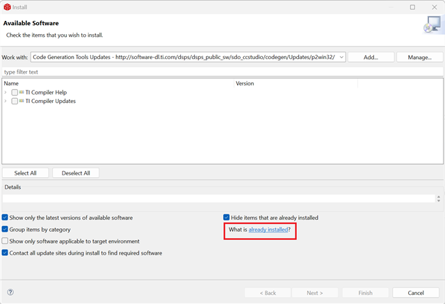

    Where can I download TI ARM Compiler v5.2.5?
    I have another question. A few days ago, I tried using the same code but built the project with the UCD3138 configuration. When testing with the development board, the checksum was cleared successfully. However, when using the UCD3138128, the checksum could not be cleared properly. Could this also be caused by the compiler version?
  • Hi Parrish,

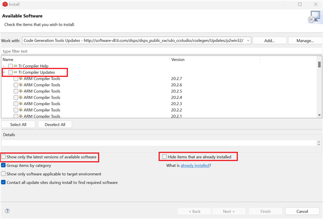

    Please follow the instructions below to download compiler v5.2.5
    1) Uninstall v5.2.9 first. For that, open CCS-> help->Install code generation compiler tools-> click on 'what is already installed'-> select 'Arm Compiler Tools 5.2.9-> Uninstall. Please see the below image
    2) Install compiler v5.2.5. For that, open CCS-> help->Install code generation compiler tools-> TI Compiler Updates->Arm compiler tool 5.2.5
    Please make sure to uncheck the options 'Show only the latest versions of available software' so that all versions will be present in the list.Please see the attached image.
    To answer your question on UCD3138, yes it is due to compiler version.
    Deepak K
    I encountered an error message while installing v5.2.5.
    My CCS is installed in D:/TI instead of the default folder. Could this affect the installation?
    I reinstalled CCS and installed compiler v5.2.5, and the checksum was successfully cleared!! Thank you!
