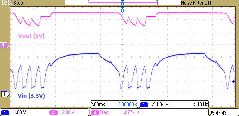

The customer designed the board by applying TLV61070A as the power for the LED Driver.
However, a phenomenon occurs where the power drops significantly at a 10ms cycle, which is the LED operation cycle.
Increasing the capacity of the input/output Cap. value or adjusting the feedforward cap value does not improve it.
Can you guide me on how to improve the above problem?
[schematic]
[Waveform]
Please check.  Thank you.

  • Hi Grady,
    It is not our device behavior that caused this phenomenon. As you can see the Vin drops first before Vout and stays low for a while even when SW is not switching. So our device is not taking any action that can decrease Vin.
    Travis

    The information was conveyed to the customer, and the information confirmed by the customer is as follows.
    - It is said that the voltage of 3.3V~6V enters TLV76733(TI)_LDO by connecting 1.5V battery in series, and the output 3.3V of TLV76733 enters Vin of TLV61070A.
    - When the FND_PWR_OFF terminal on the circuit diagram is OFF, the waveform is clear, but when the FND_PWR_OFF terminal is ON, the above phenomenon occurs.
    - It seems that the load has an effect because the drop occurs more as the load increases.

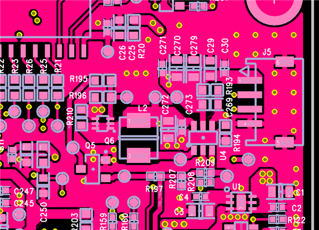

    Q3) The customer requested a review of the circuit diagram and PCB layout privately. If you reply to Private E2E or my email (grady.lee@arrow.com), I will send you the schematic and PCB layout. Could you review it?

  • Hi, Travis
    I have sent you a Friendship request to send you the schematic and PCB files using private E2E messages.
    If you accept, I will send them to you.
  • Hi Grady,
    I've checked the schematic, and I still don't understand why FND_PWR_OFF makes a difference when Q6 is not fit. Please share waveform with Q6 and Q5 removed. And add VLDO_IN and VBAT waveform in the screen.
