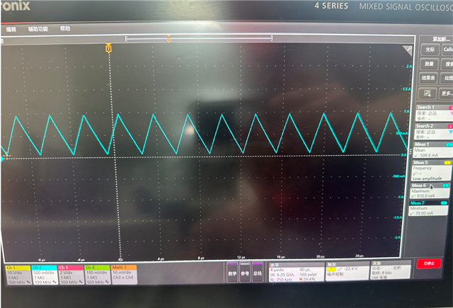

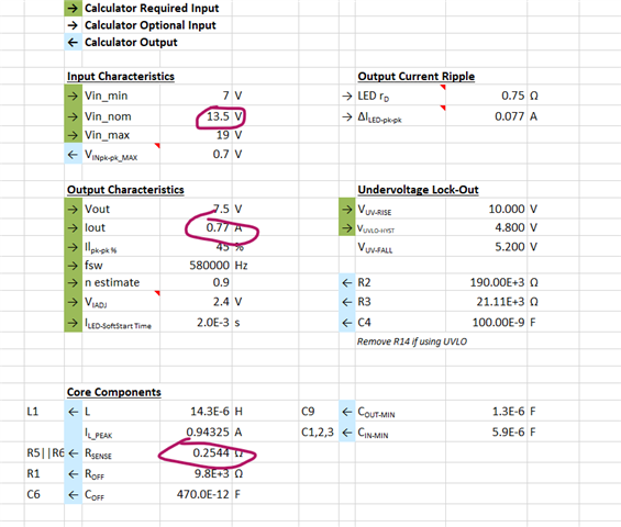

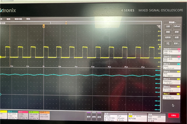

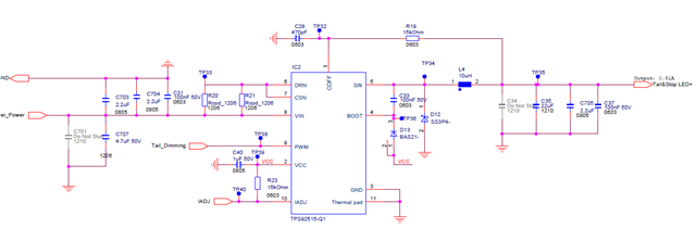

hi team,
May you help review the sch design and check what are the possible reason for output current not meet setting?
Calculate Iout=0.77A but actual test results is 0.5A, if we change the Rsense value, the Iout will change as well.
