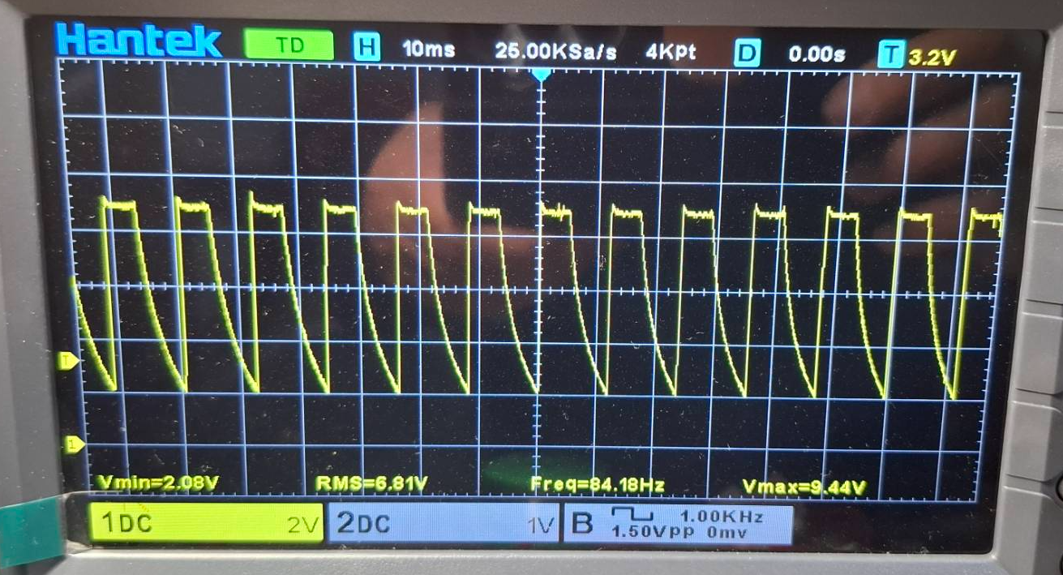

We occur TPS92515 noise issue.
Input voltage :9V
R15:20K
R14:10K
1.When the TPS92515 is operating without a load, the output voltage (LED1+, LED1-) exhibits the voltage waveform shown below, which is not a constant voltage output. How can this be adjusted?
2.When testing the TPS92515 with an electronic load in CR mode, why is the output unable to maintain a constant current?
