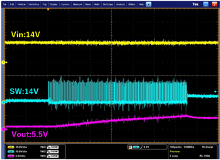

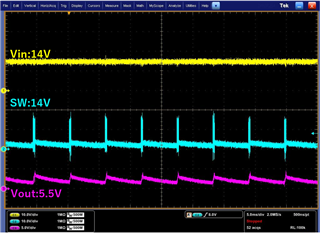

Hi team,
I'd like to know about start-up failure at Low Temperature( using a cold splay).
Waveform as bellow.
Could you tell me why it won't start up?
Soft start( tss) = 670us
*5ms/div
*100us/div
BR,
Kengo.

Dear Kengo,
Did you see this issue only when the temperature is cold? And what is the temperature now? Could it be reproduced for all devices and all boards?
Could you pls kindly share with me the schematic? I am not sure if you have very large output capacitor, but I recommend you can try to increase the Css (soft start capacitor) and extend the soft start time to around 5ms to try.
Thank you!
BRs
Lucia

I tried to change soft start (6.7ms)
There were no problem to start up with cold.
Could you tell me why this is?
