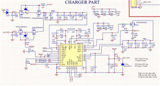

Below is the relevant registers setting and hardware design schematics. Can you help analyze the cause of the problem?
The register setting:
The schematic:
Kind Regards
  • Hi Lumina,
    I see a few schematic issues.  The main issue is no capacitors on SYS.   PMID and SYS are the input and output to the converter so those must have minimum capacitor after derating for applied voltage and temp per below:
    You might be able to move some of the VBUS capacitors to SYS if their voltage rating is high enough for 4S pack.  Please keep in mind that ceramic capacitors derate significantly with applied voltage.
    Also, the cap on VREG after derating for applied 5V needs to be 1uF.  If that 2.2uF is 16V rated or higher, it might derate no lower than 1uF but if lower, probably not.  Although probably not an issue, the BTSTx caps that will recommend are 47nF not 100nF and the additional 47nF on SDRV is not needed.  But for 4S, we recommend a 47nF on BATP if a fully charged battery will be hot plugged.
    Regarding the register settings, I don't see any issues except for fsw=750kHz and inductor = 1uH.  We only support inductor =2.2uH with fsw=2.2uH.  Also the watchdog timer is set to 40s so any charge related registers revert to default settings after 40s.  Lastly, there is no need to write EN_ACDRx =1 after reading the ACx Present bit because the charger automatically does that.
    Jeff

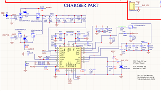

    There is no system load need, we just using the BQ25792 to charge the battery, so we floating the SYS.Is this feasible?
    Following your suggestion, we have redesigned the circuit as follows:
    On the new PCBA, we have measured that the SYS pin has output current, but the BAT still has no current output.

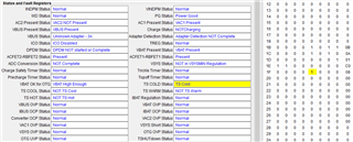

  • Hi Lumina,
    What do the status and fault registers from REG0x1B to REG0x27 report?
    Jeff

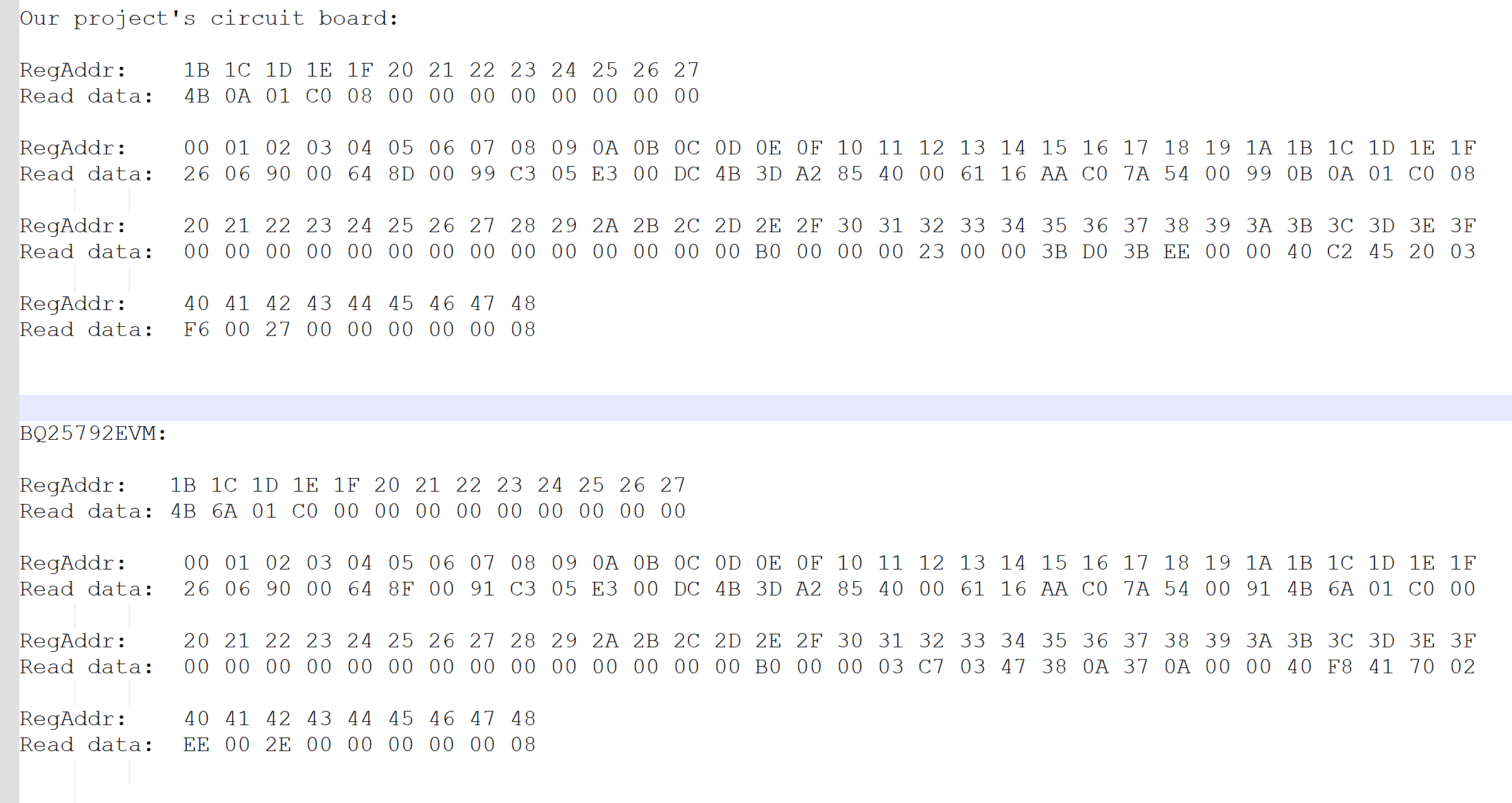

  • Hi Jeff,
    The rgisters setting of BQ25792EVM and our own PCBA is as below:
    Kind Regards
  • HI Lumina,
    The charger is in TS cold.  What is the voltage TS pin?  Is a thermistor connected?  If not, use the host to set REG0x18[0]=1  or change TS pin resistors to equal values to disable TS pin function.
