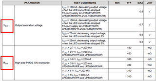

      • And the voltage level of VLED should be higher than the sum of (Vforward of LED + voltage drop on the highside FET + max VSAT), in which the voltage drop on the highside FET = Rdson of the FET * total LED current, the Rdson and VSAT can be found in the datasheet EC table (as shown below).
      • And the real VLED voltage should be selected as close to the calculated value through the formula above to minimize the power dissipation on the LED driver, as the main power dissipation of the driver = (VLED - Vforward of LED) * sum of the current.
