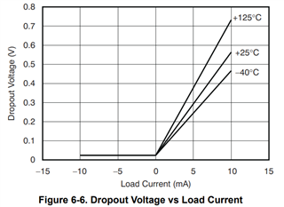

    For this application, my recommendation is REF50 or REF50E. As long as the load current remains below ~3-4mA, the dropout voltage should be fine:
    This is seen on page 11 of the REF50 datasheet. It seems the VREFHI input current is 190µA seen on page 155 and page 157 of the F28386 datasheet:
    Since there are 4 VREFHIx pins, I would expect typically less than 800µA of current being drawn from the voltage reference.
