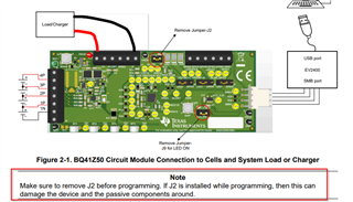

    Can you please share a picture of your current setup?
    Can you please share more details about this issue that can help us to understand a bit more?
  • Sure thing.  Note that I also duplicated this on the BQ41Z50 EVM.   Here's a picture of my setup with the EVM, the setup is a 4 cell pack connected to the BQ41Z60 EVM with a Keysight N6705C with an N6781 SMU measuring the current.   I'm doing low-side measurement so the current source is in the ground path between the ground lead of the battery pack and the ground lead of the EVM.

     Here's my setup
    A few questions.
    1- Are you using RevA of bq41z50?
    2- Please remove the J2-Jumper if installed.
    If you programmed a FW while J2 installed, it can cause issues with the board. This is explained in Users Guide.
    I would recommend ordering the Rev.B board which is available to order. Or replacing the IC.
