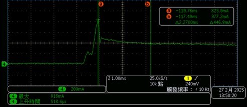

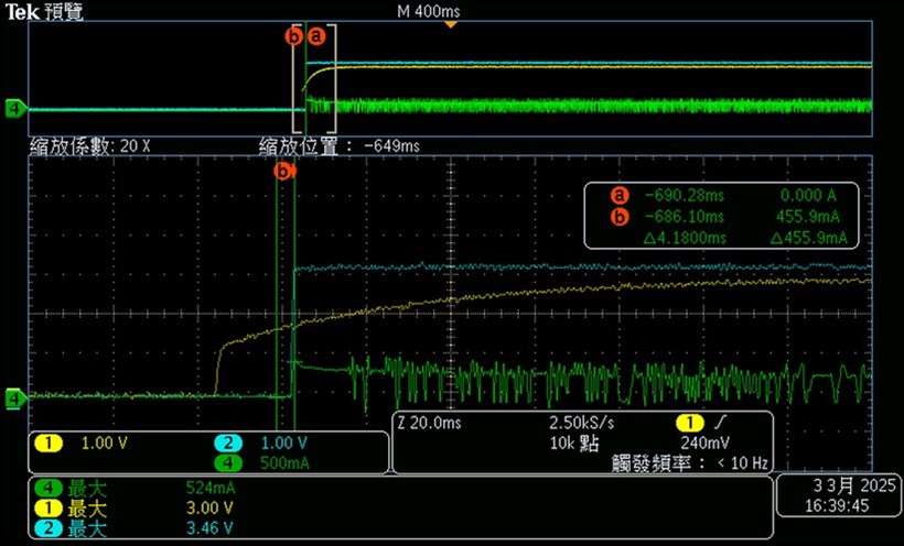

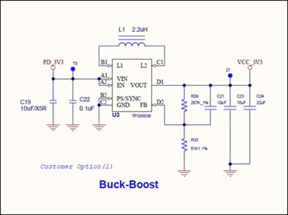

My customer is using the TPS63036 and found it has the high inrush current, could you advise some comments to fix this issue? Thanks!
schematics:

Ch1 (yellow): Vin voltage
Ch2 (blue): Vout voltage
Ch4 (Green): Vin current
