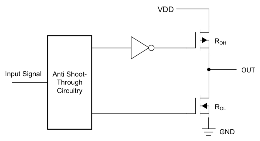

I am using only DC test methods to test the Output Resistance High & Low. Will DC test methods correctly measure the PMOS only not the N-Channel Structure as mentioned in the data sheet?

    The output structure may have changed between the old and newest part revision. The hybrid structure might make it difficult to get an accurate DC reading.

    The UCC27322 and its family of devices (UCC2732x and UCC2742x) received a PCN in late 2023. The older version of the device (pre-PCN) used to have a hybrid output structure, which is the one that Walter posted. The post-PCN version of the device now has a strictly MOSFET only pull-up and pull-down output stage:
    This new output stage results in a lower output turn-on and turn-off resistance, yielding faster and more efficient switching. I’m currently in the process of updating all the datasheets in the device family to account for this change that was missed in the latest revision.
    It is most likely the case that the EVM you ordered has the pre-PCN version of the device installed, thus the current datasheet parameters will not match up with your testing. Walter linked the previous revision of the datasheet, which would be more likely to match your test, but the customer will be receiving the post-PCN version when they order the devices.
