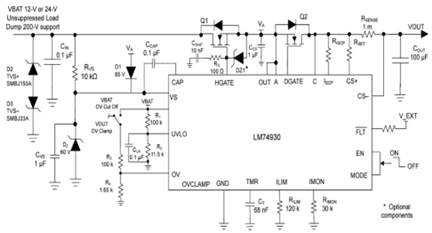

I am working on a battery (INR18650) protection circuit against polarity inversion & overcurrent (possibliy voltages min/max).
In a previous topic, the following schematics was suggested to me in order to allow bidirectional charging / discharging (battery can be charged over USB).
LM74930-Q1: Polarity inversion protection + battery charger : https://e2e.ti.com/support/power-management-group/power-management/f/power-management-forum/1452194/lm74930-q1-polarity-inversion-protection-battery-charger
I implemented it but I am experiencing some issues : NMOS does not activates themselves and so the power output never come ;
- Vin is supposed to vary from 3 to 4.2V (battery cell)
- when Vin < 5V, Vout = 0V
- when Vin > 5.4V, Vout have a strange behaviour (only since I added the diode drawn, before, nothing happened whatever the voltage is)
- I tried to remove OV (tied to GND then) / UVLO (tied to VS then) and ILIM (tied to GND then)
- It changed nothing.
Any Ideas ?
Nb : MOSFETS are Toshiba TPN1R603PL,L1Q

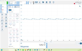

Below are for Vin > 5.5V : VS (left), Va (mid), Vout (right)

  • Hi Jimmy,
    I see that OUT/A to VS diode is missing in your schematic. Can you add it and test again?
    Shiven Dhir

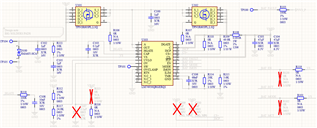

  • Dear Shiven,
    Hope you are doing well and thanks again for your support !
    I tried placing a diode as mentioned but it changed nothing infortunately.
    As an example, With Vbat = 4.4V (stabilized power supply), Vs = 3.1V, Vout = 0V, Dgate and Hgate = 0V.
    I even tried to remove "optional features" Ilim, UVLO, on a second board (with respect to the datasheet but nothing changed.
    Riscp = 0R
    Rest = 49.9R
    Rsense = 0.001R
    EN / MODE connected to Vbat
    on first board, OV not used, UVLO = 0.6V when Vbat = 3V, 100K ; 25k , Ilim = 20K -> target = 30A
    on both board, Rmon = 3.6K -> full load for 30A
    Any ideas on what is happening ?
    I made additionnal testings : I had the feeling that Vs voltage value was a thing, so I shunted R1 (Rset).
    Now the module is working I have Vbat = Vout with some specific behavior :
    - When Vbat is changing (let's say form 5V to 3V), everything is linear.
    - If Vbat is going below 3V, then the Vbat << Vin (around 1.8V for 3.3V or 2V for 4V, see picture) until Vbat reach 4.2V (or higher), then everything is going back normal
    this has been tested on a bord with UVLO and ILIM used (so 3V is supposed to be the threshold I set up)
    Finally, if the power supply is inverted (RPP):
    - the system is going back linear if Vbat >= 4.2V
    - is having the same not linear behavior if Vin < 4.2V (this is solved when Vbat cross again the 4.2V limit
    Hope this can give you some additional informations..

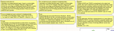

  • Hi Jimmy,
    I suspected R111 to be an issue which is not letting VS rise at low voltages. That resistor is added to fight some transients, and I think they are not expected in your system. Hence you can choose to remove it or lower down its value to something like 100 and test again.

  • Hi Shiven,
    by linear i mean (but you are right, it is not the right term) having Vbat = Vout
    I tried with 100R. It work the same except when i draw current -> it make the situation a bit better, thanks
    I have a second issue : the max current is supposed to be 30 Amps according to the settings (and without errors) but when the consumption goes higher than 5 Amps (average), the system cuts.
    I tried the short Rilim to remove the overcurrent protection.
    I got some fluctuation but nothing going under 3V
    Any ideas ?

  • Hi Jimmy,
    I hope UVLO is not getting triggered as it set to 3.01V(typ).
    Can you disable UVLO and test again? You can remove R117.
