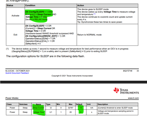

Would like to confirm the activation conditions for bq27z746 SLEEP and SHELF modes:
To go into the SLEEP mode the device does not need to receive any external commands. And as long as the DA Config (Sleep) =1 and the voltage and current conditions are met, the device will go into this mode
For SHELF mode an external command must be issued - OperationStatusB(ShelfM)=1 (if the voltage is > ShelfVoltageThreshhold) and the current condition is met, the device will enter SHELF mode.
Please, confirm or correct my understanding.
