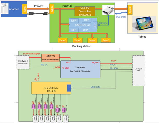

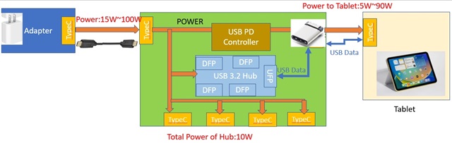

Dear TI team,
   I'd like to design a docking station for charging Tablet and transfer device's data from USB port to Tablet.
 The block diagram is as below, could you help to check if any problem? Thanks.
